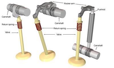

To understand shim over bucket, shim under bucket, and tappet... Here are some diagrams to help understand if you dont know.
This would be a tappet system, using a rocker arm.  These are the ones that you will get the most ticking or rattling sound.  It has much more moving parts above the valve that can wear, causing a loose valve.

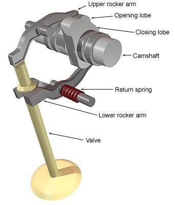

I decided to add this too...  this is a desmodromic system, what Ducati uses.  This can rev much higher than a shim under bucket because it does not us a valve spring.  In Moto-GP honda complained that there should be a rev limit on bikes, because the Ducati could rev over 20,000RPM with no valve springs, using an opening and closing cam and rockers instead of a valve spring to close the valve... Valve springs start to float at about 18,000 RPM and can not keep up with the high RPM.
