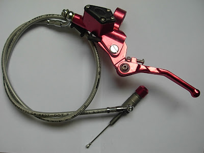

« Reply #18 on: January 27, 2010, 08:20:26 AM »
Ok still waiting on Magura .....  :-\
but in the meantime
being impatient ....
impulsive .....
and cheap .....
I bought one of these sets off Ebay:
but in Silver
 ..... not really thinking it would fit the Hyo but just semi amazed at the price, so thought I'd get one to play with and fit it on one of the littler bikes I have here. It kinda suggests its for pit bikes etc.  :-\
It arrives .....
its not a badlooking bit of gear  :o
its pre-assembled and hasn't lost any fluid  :o
and to be honest I think it will fit almost straightin the Hyo  :o
Not dead sure the hose is quite long enough as is yet though  :-\
so in a few days time I will fit it and see how it goes.
Imagine that ..... a hydraulic clutch kit for < $AU50
 ;D ;D ;D
and for the Ebay/chinese product sceptics ...... I also ike quality however I also take pride in my cheapness ...... I'm hoping it works and I won't even need the Magura stuff  ;)
« Last Edit: January 27, 2010, 08:33:30 AM by hyowhistled »
