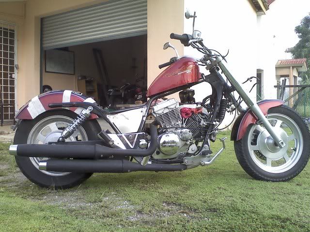

LOL... Well I'm thinking about doing a make over on a GV250 similar to the Sporster style makeover pic below (courtesy of Azroy of this forum)

Reason I ask about how much is I have seen extender tubes made years ago. They basically fit in between the two triple clamps and into the top clamp like the top of the existing forks. Then they were clamped where the tops come up to now and just above the bottom triple clamp.
If you are game you could find a machinist who could knock some up. But they have to be strong and you have to make sure the existing forks have enough beef around where they are now clamped. And they would probably only give you another 50mm, and I wouldn't want to run into anything with them.
or how about a machine shop making you up some whole new fork inners? Then off to a chrome plater. Or even better someone who does that goldy low friction coating.
Often the machineshop and a bit of friendly chat gets you a pretty cost effective job.

I was thiking of using the forks from a GV 650 as the basis (I really like their look) and getting the bearings redone to fit the GV250 frame if there was no off the rack option available. I'm yet to find one (sigh)

I am gonna HAVE to pick your brains at some point about the front end there! LOOKS GREAT MATE!!!!  ;D
