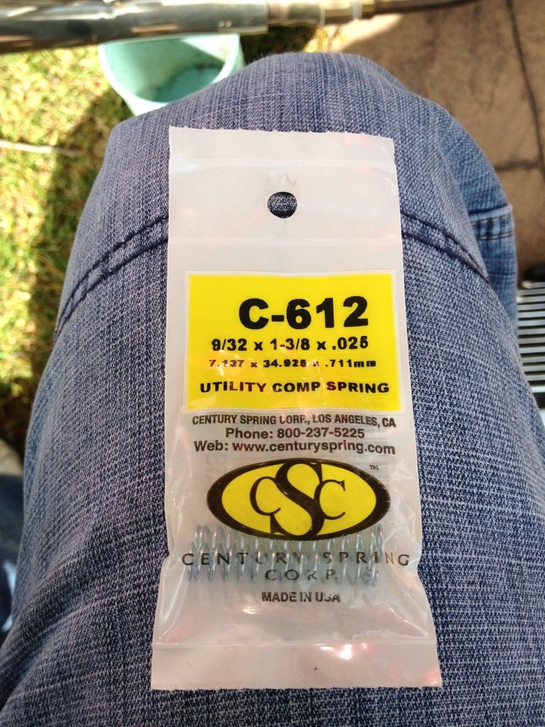

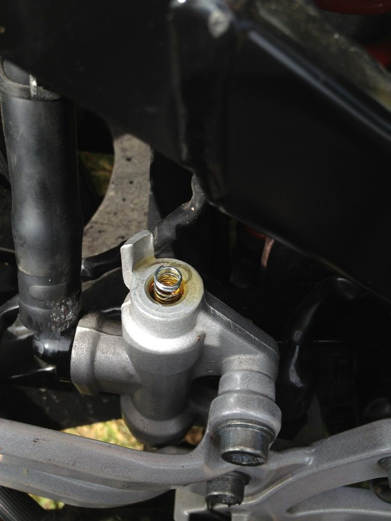

So I decided to look at the whole cylinder and decided that the poor part is the spring. Its just plain not strong enough. Further thought on the matter had me decide to find a spring that I could fit inside the existing spring.  I sourced one at the local hardware.
Its a CSC C612. ( I tried the C614 but it was a tad too strong so i backed it off to a C612 ). The great thing is that this spring can be fitted merely by removing the top banjo bolt, dropping the spring in then reattaching the banjo and bleeding the banjo.
Voila its great now. Didn't even need to clean it! or pull it off the bike.

Its a century spring co. C612. Google it I've lost the packet.
It just slips inside the existing spring.
http://www.centuryspring.com/Products/compression.php
http://www.mayohardware.com.au/products/catalogues/cs/2011/CenturySpringf_FullCat_Nov10_web.pdf
http://www.doitbest.com/Door+springs-Century+Spring+Corp-model-C-612-doitbest-sku-749293.dib
Thank you very much. I wasnt sure if that was the universal nam and pn or specific to a certain store. I didnt want to go to the hardware and look like an idiot asking for a spring. LOL
No need to trim the spring, correct?

« Reply #14 on: January 18, 2012, 01:43:57 AM »
No, no trim needed, the preload is just perfect ( for the C612 ) when that full length is compressed under the re-fitted banjo bolt.

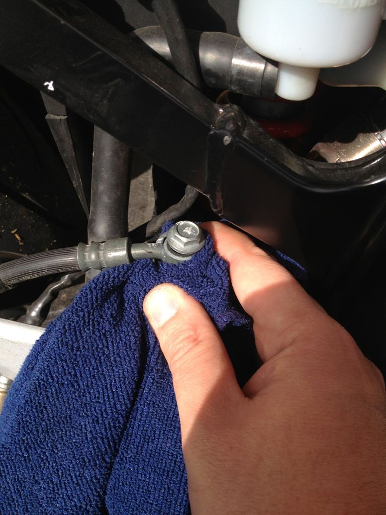

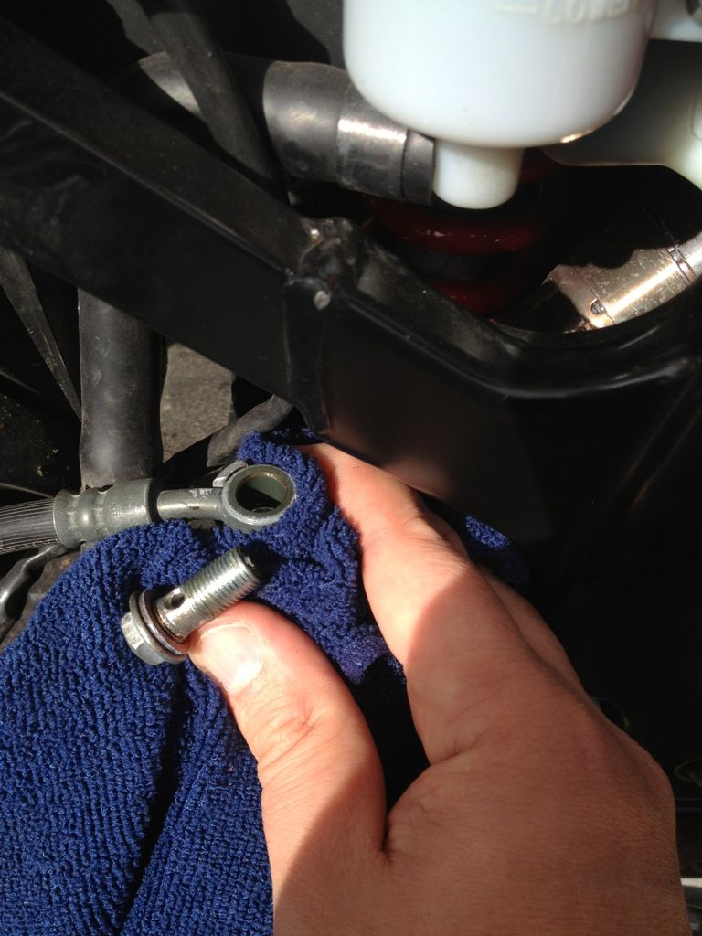

And so you know how you just wander around Bunnings just to find something to do, right?
Well, here is what I saw, over near all the stainless steel hex bolts I am always finding 'reasons' to buy..
Voila! Something to do!! yay!

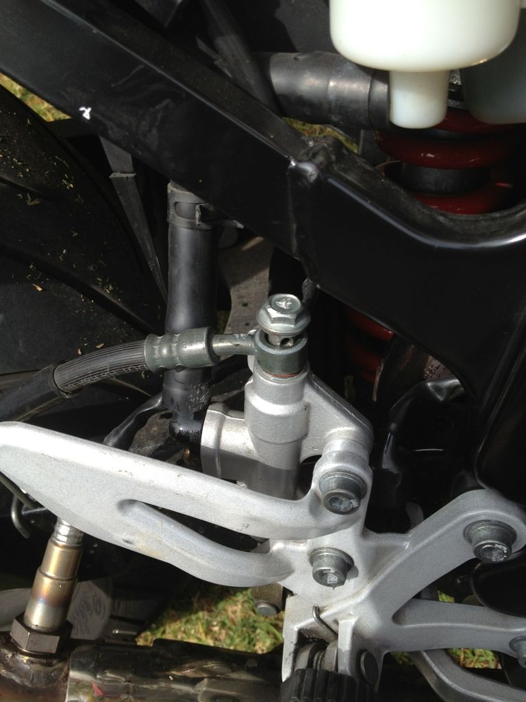

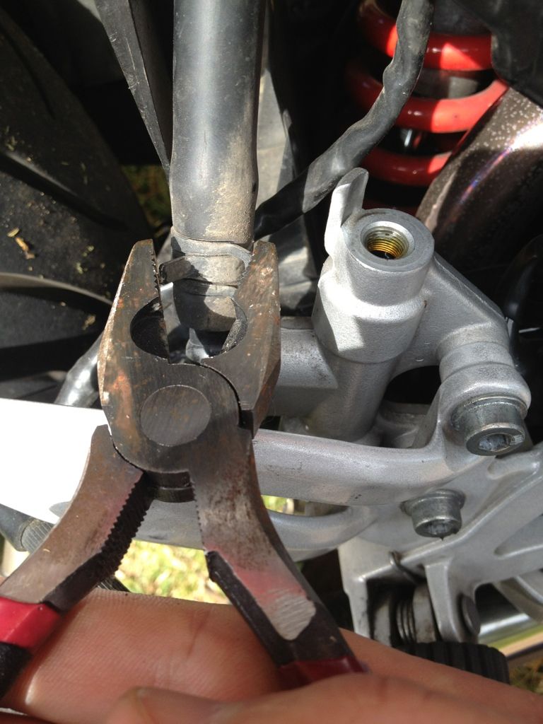

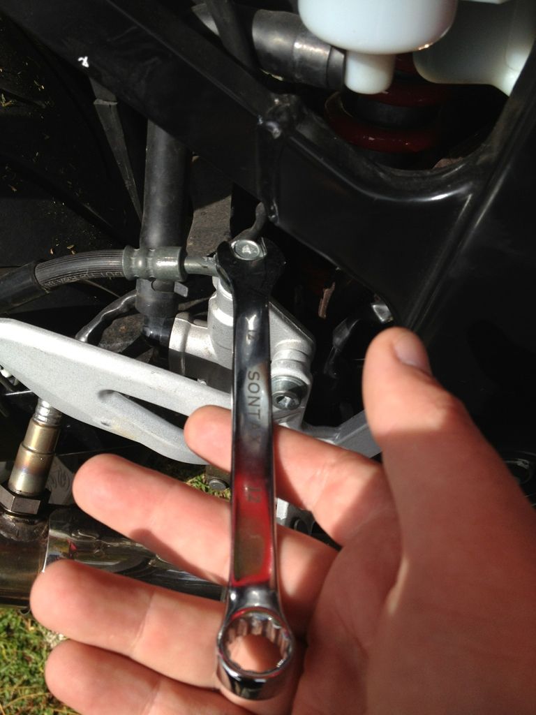

So anyway, I happened to have near me a set of spanners handy and a pair of blunt nose pliers..
Anyway, the brake fluid in the rear was old.. so I figured, I would put the pliers to good use..

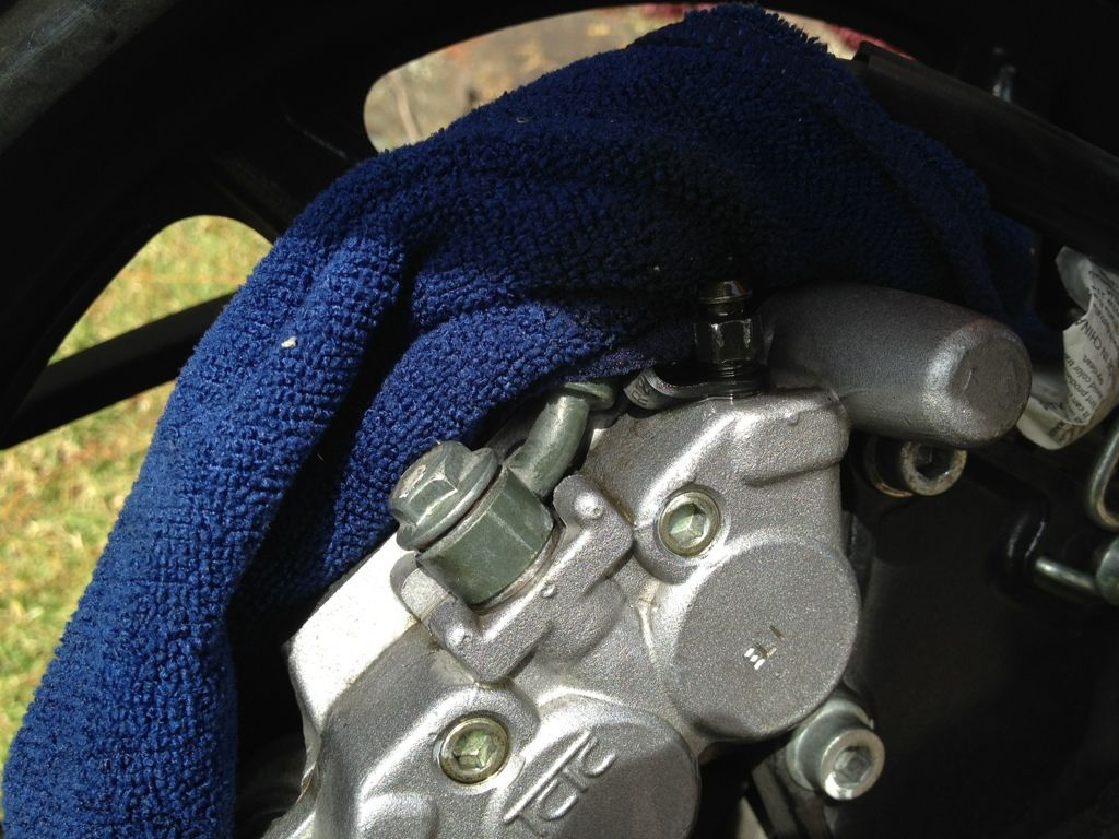

Ohh and by the way.. Brake fluid + painted surfaces = bad, ummkay?

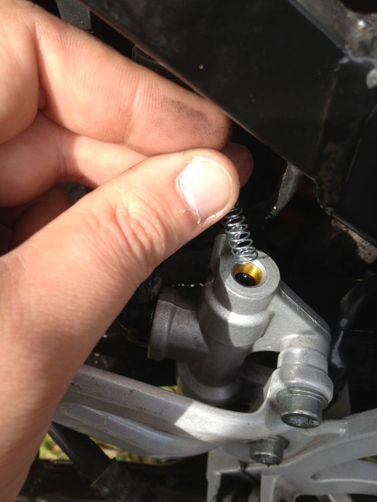

In goes the silver pill..
Don't over tighten, because you will need to bleed the air from that banjo bolt..
A particularly bad video of how to bleed air from a banjo bolt:

Once you have bled the banjo bolt, you will also need to bleed the rear caliper, from it's bleeder nipple.
You will need to do this A LOT.
I am not here to debate the pros and cons of the various vacuum bleeding/plumbers tape bleeding methods. The whole pump, pump, squeeze, twist, close, repeat method works fine for me.. The trick is to close the nipple off BEFORE the pedal drops to the bottom.
