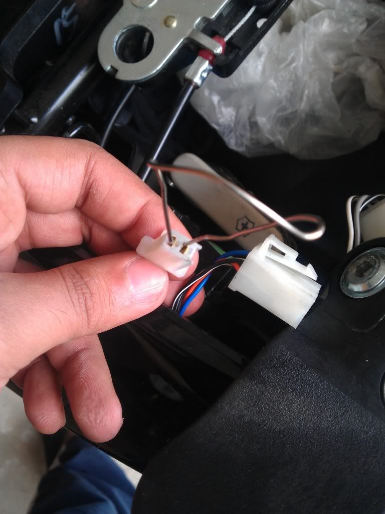

here's what i posted up in another forum a lil while ago:
you can check the error code yourself at home.
open the rear seat and on the LHS (standing behind the bike) under the rear fairing, there is a white 2pin connector. put the bike in neutral with the kill switch to on and turn the ignition on, so the dash turns on. wait a few couple of seconds, till you see 0kmph on the dash and then put a paper clip in the connector and about a second or so later, you should see the codes on the screen
it should tell you code in terms of....C41 etc..
if there is no errors recorded, it'll just show a C or C00
and then look it up in the service manual.
here's the link:
you're after the GT650 EFI manual.
http://www.hyosungmotors.hu/download...ervice-manual/
here's the how to short it out:

I've found the plug it has a black wire and a white and black wire coming to it ?
What does shorting it out do ?
that is the plug. the pice above will show you how to do it.
Shorting out the plug, shows you an error code on the dash and then you can check the error code in the service manual. it'll tell you whats faulty and also, possible ways to fix it.
