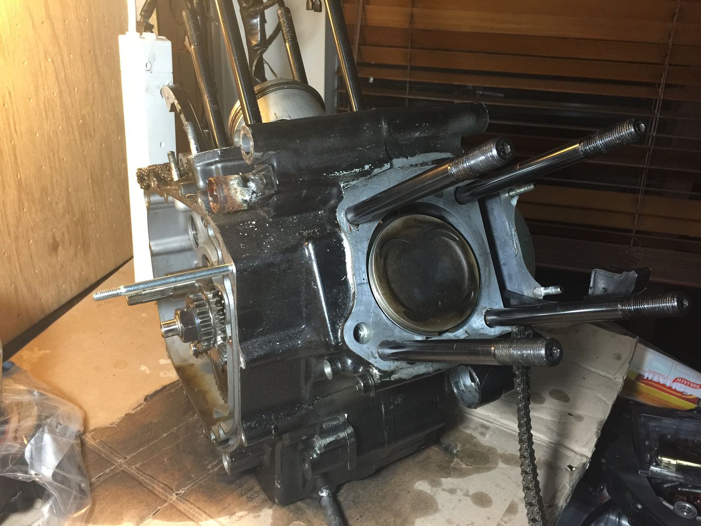

Got the engine out over the holidays.
Slowly started picking at it in dribs and drabs.
Some pics of where I have gotten up to.
Engine block with view of upgraded head studs:

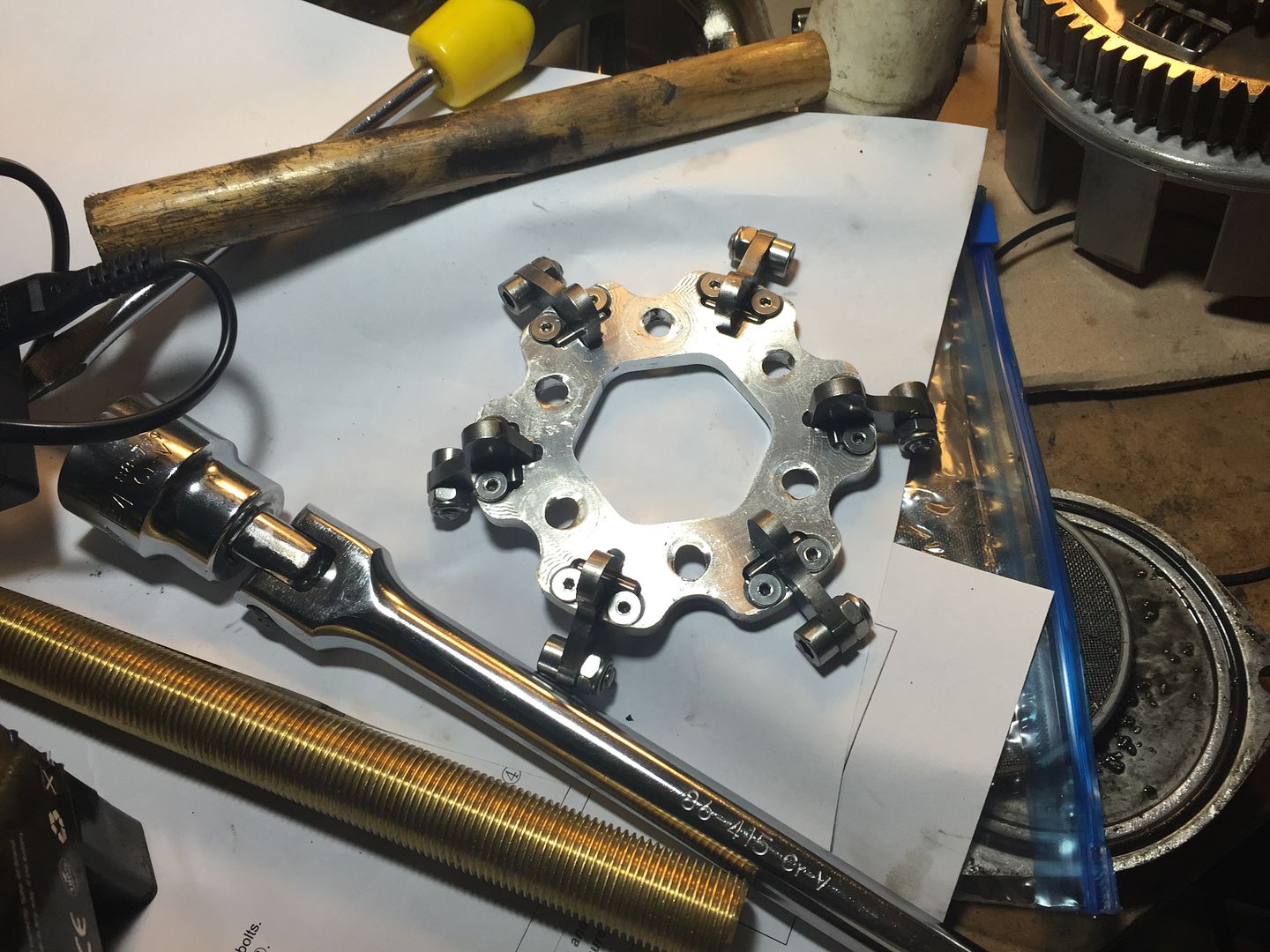

The centrifugal force driven, cam actuated clutch hat thingy: (note the metal bits in the strainer)

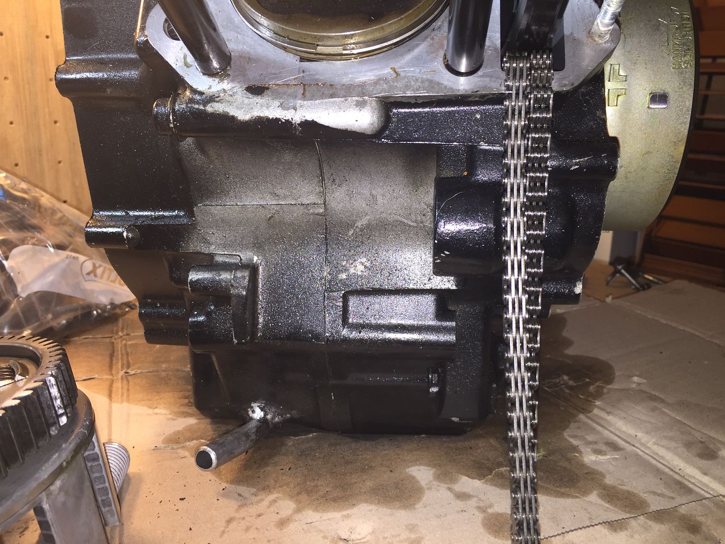

Oil return:

Wow looks like shes coming along nicely, you run into any/many problems so far?
umop-ǝpisdn
  • Posts: 7539
Re: Turbosung V2
« Reply #17 on: January 04, 2016, 07:44:28 PM »
A couple.
I was short a pair of hands getting the engine out of the bike. The bastard's heavy if you're flying solo!
The piston sleeve base gasket was also impossible to remove in one piece. I have to cut it off. It had beed bolted into place by the head studs. Anyway, I cut them off and enlarged the cylinder head stud holes on the stock gasket to go back in it's place.
Currently stuck waiting for a bolt to arrive so I can remove the magneto rotor. Had to order an M20x1.5x50mm bolt which no one seems to keep. Having to order it from a specialty fastener supplier.
Other than that it's been slow and patient. Trying not to hurt anything.
