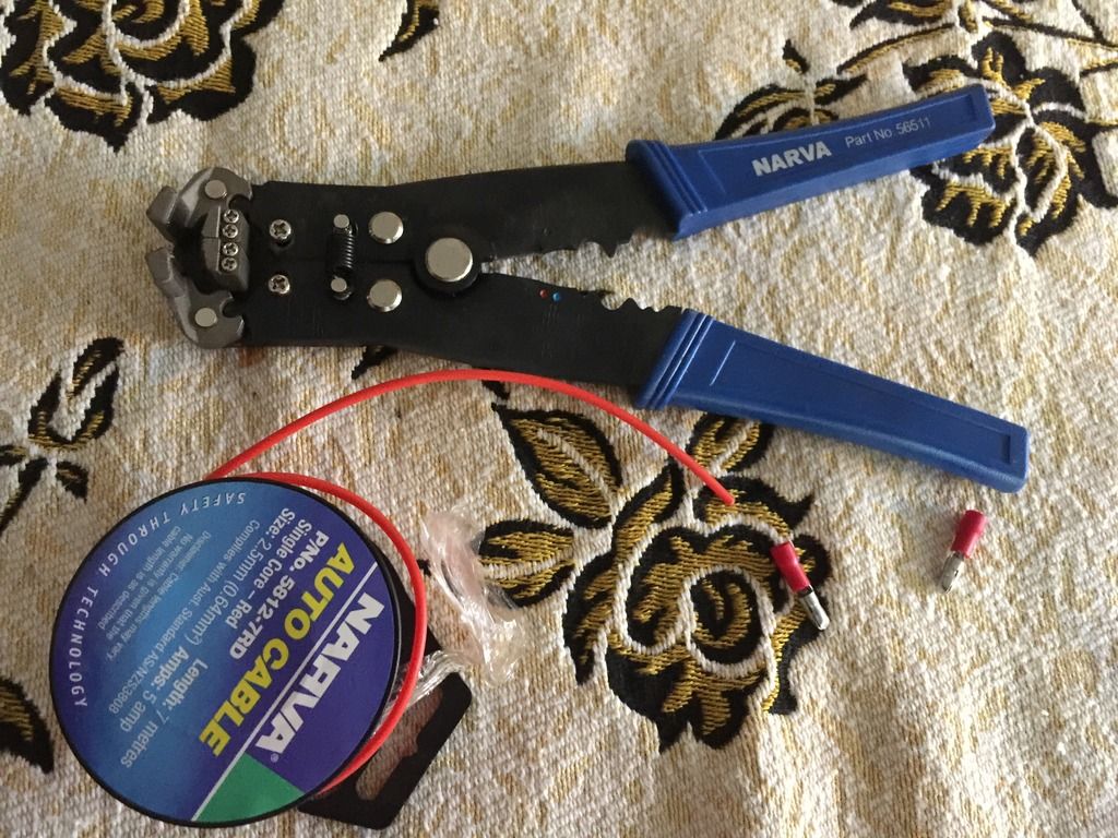

1st, you need to make a pair of these loops. One to bypass the clutch safety switch and the other to bypass the side stand safety switch.
You will need some wire, four bullet connectors and a crimping tool.

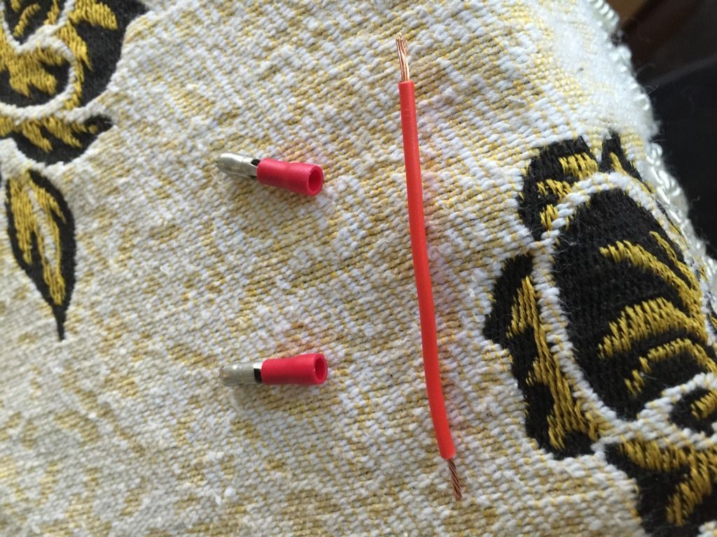

Strip the ends off
Crimp:

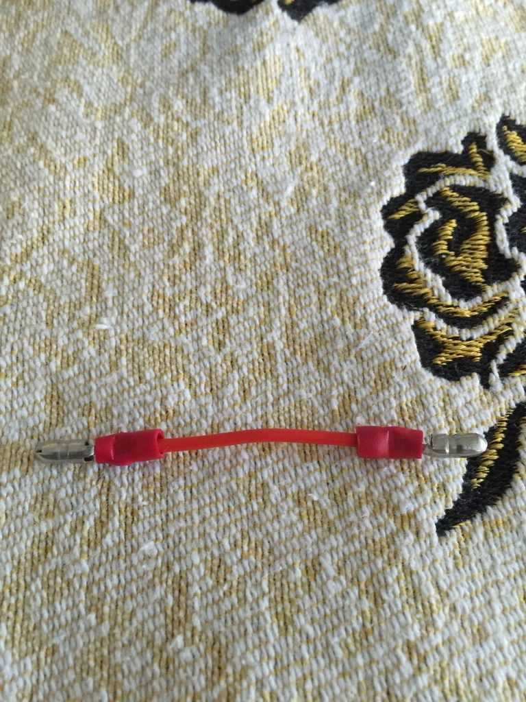

Finished product:
A firm, but not ridiculous tug on each connector to make sure it's on right.
