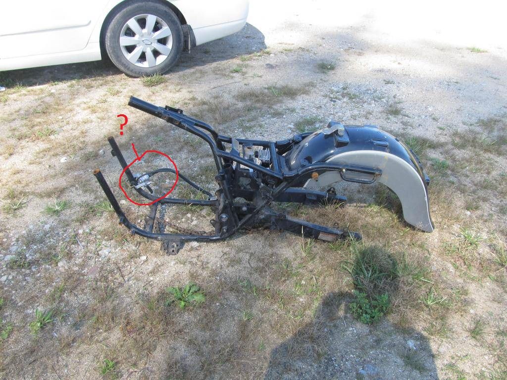

business end first- what is this part???

Secondly- that blasted thing in the first few pics. I went today to two different mechanics, both were confused. First guy said "water pump" ...I smiled at my special lady friend , thanked the man, then promptly walked out, cursing under my breath. Spent the next 10 minutes walking home, trying to explain what air cooled vs. water cooled is and why my engine doesn't have a water pump.
went to another guy- this one had "KR", which of course is the successor to Hyosung on his sign- i figured he HAS TO know.
 Most motorcycle shops here deal with the ubiquitous delivery bikes, which are usually around 120 cc  and are ridden as if they are a 12 year old being chased by subway Jared.  So that's where most of their business comes from. Of course they see other bikes- he had a 125 mirage out front...but it was an older model, older than the one my engine came off of- didn't have that part.
He also didn't know what it was exactly... he though it was 'blowback valve', or as they say buh-low-oo-ba-kuh' bal-buh...so i figured some kind of ventilation system PCV or whatnot?

That is a bit of a mystery part that one. No idea, but I agree that it has to be some kind of air pump. Either an exhaust air injection system or something similar.

It looks like a Secondary Air Valve Solenoid. My 2010 GV250EI has one. It is for directing air into the exhaust ports to help burn unburned exhaust vapors. They are on the fuel injected model engines but dont know if they are on the carby engines as well.

It's a carby GV250, yes?
Right, carved bike

Does this help?
http://hyosung.hu/download/pdf/data/alkatresz-katalogusok/GV250%20PARTS%20CATALOGUE.pdf
I WENT thru that PARTS catalog,I think the engine I have was from a bike made after 2003, when that doc was published.
Likewise my older gv250's didn't have this part.
